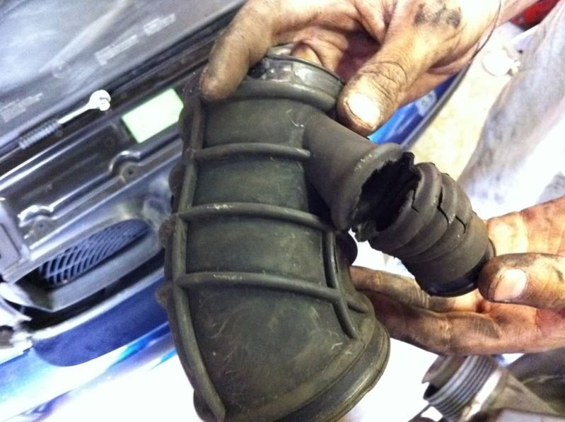

  • LocationNW London
  • Current Car:2000 528i Sport
Posted 11 December 2011 - 11:23 pm
I bought my car with the engine management light on, it had a rough idle and would also hesitate when moving off. I noticed a loud hissing sound from the engine bay which lead me to believe it would be a vacuum leak somewhere, hence why i bought it. I found that the rubber boot going into the throttle body has another pipe going off it had perished (i think it leads up to the idle control valve). But im guessing here - if you had that problem your car may have been alot worse and throw up countless errors linked with improper burn across your cylinders and dodgy lambda readings. but worth a shot anyway mate. mines a 2000 528i by the way m52tu
